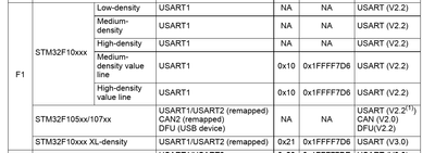

Dear STMicroelectronics Support,
I am writing to express my urgent need for the necessary drivers to use my STM32 Blue Pill development board with STM32CubeProg on a Windows 10 64-bit system. I have been unable to find or install the correct drivers despite extensive searching and troubleshooting.
This delay is significantly hindering my project progress and causing considerable frustration. I kindly request your immediate attention to this matter.
I have attached for your reference. Please let me know if any additional information is required.

There is no driver. STM32F103 does not support USB boot, so you need either the debug interface (like ST-Link) to program the STM32F103 using SWD or some USB-UART module to use bootloader via PA9, PA10 pins.

Make sure BOOT0 is HIGH for the STM32 ROM System Loader to start when plugged in.
AScha.3
So you want boot from direct USB connection on Blue Pill , with F103 cpu ?
I see small problem here: F103C8 or CB has no USB boot built in.
see AN2606:
-> can boot from usart1 connection - thats it.

Well you're connected to the USB pins of the STM32F103, but without any firmware that initializes those pins as some sort of USB device, it's not going to enumerate.
If you're developing FW and debugging/programming, you'll need an external programmer/debugger like an ST-Link V2 (or even the cheap Chinese knock off), and program through the SWD pins opposite of the USB connector of the Blue Pill.
