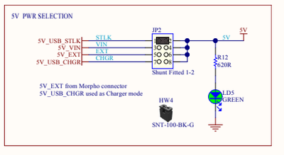

nucleo stm32h755 has a faulty stlink charging circuit
  • July 19, 2024
  • 1044 views

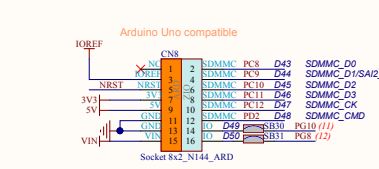

I accidentally disabled the 3v3 pin on CN8, so now my Nucleo h755 board can no longer load the code.
In this case is there a way to save?
Thanks,

AScha.3
July 19, 2024
What you "disabled " on pin header ?
For flash the code, st-link is connected on CN1 , and powers also the H755 .
So check JP2 :
Ruồi
RuồiAuthor
July 19, 2024
I connected pin 3v3 on CN8 to pin GND.\
STLINK is still alive but STM32H755 can no longer be seen.
