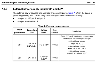

After I load my code ( with help of IDE) into NUCLEO MCU via USB cable, I'd like to disconnect it (disconnect USB cable) and power NUCLEO with battery(s) or external power supply ( lets say 3V or 5V).
Is there any PDF where to read ? Or brief explanation please
1 REPLY 1
Go to the product page -> Documentation -> User manual.
https://www.st.com/en/evaluation-tools/nucleo-f411re.html#documentation
https://www.st.com/resource/en/user_manual/um1724-stm32-nucleo64-boards-mb1136-stmicroelectronics.pdf
The User Manual has a section to describe how to provide power externally.
