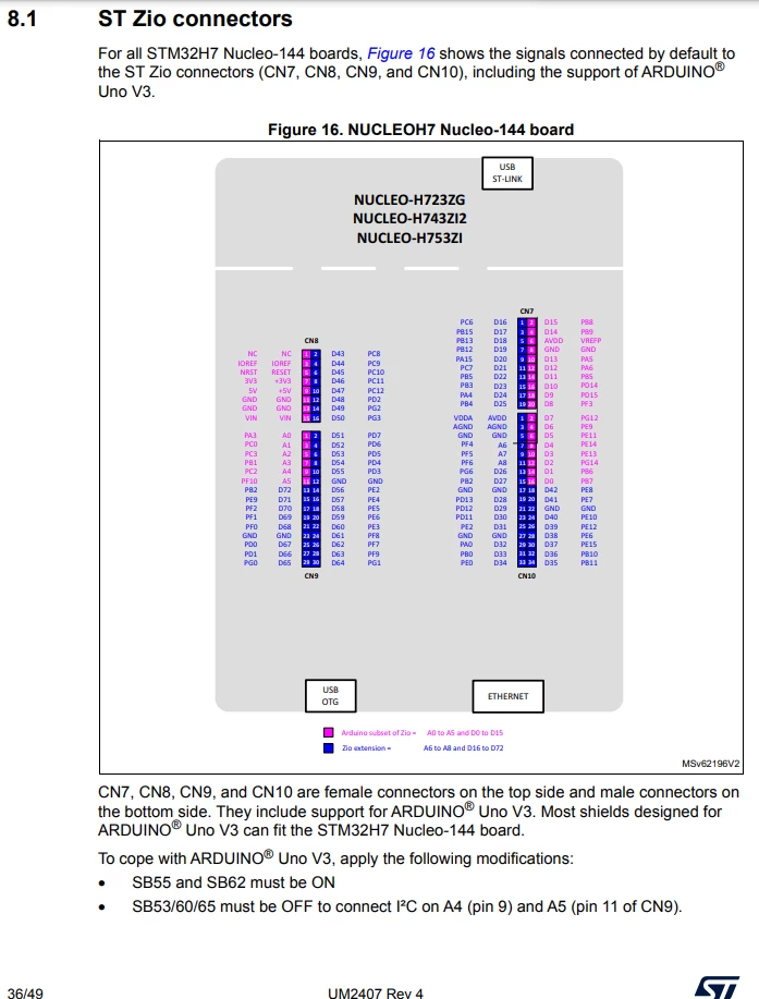

I want to use the Nucleo H723ZG for a project with analog & digital lines and can't find the article number of the headers CN7, CN8, CN9, CN10. Is there a specific cable/contact type I can use to plug in the black header body? Or are the headers pins at the bottom of the board meant to dock on some connector? Are there recommended docker boards like from Seeed Studio?

The CNx pinout description are provided in UM2407 Table 18 to Table 21.
You can develop your own board that fit these connectors and plug the Nucleo to it.

You mean what ST call the "Zio" connectors:
As it says there, these will mate with standard ARDUINO® Uno V3 shields - so they are just 0.1" pitch headers, on the Arduino layout.
