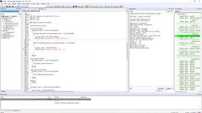

im using an Nucleo-H723ZG board as an USB Host.
im using an basic USB Mouse and the eventcallback funktion to print out the input from th mouse.
the problem i have now is that i dont get many of the informations from the mouse like the Vendor IDand others.
how can i ensure that i get the VID of the Mouse on my Nucleo.

Hi @Jacob_M_R
Sorry for the inconvenience. But the example for host from cube firmware is working without issues as well on Nucleo-H723ZG. Here is a screenshot.
I can get PID and VID of the mouse.
