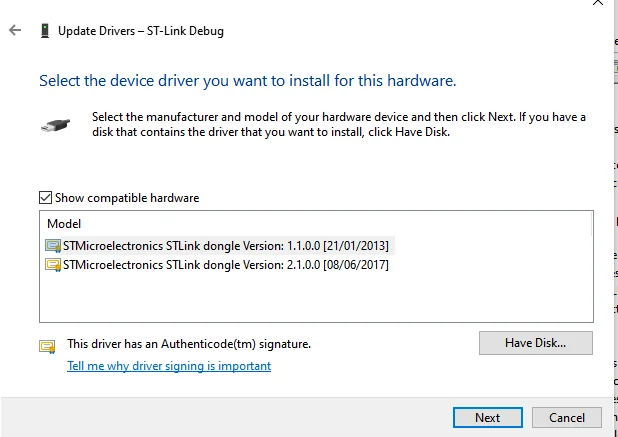

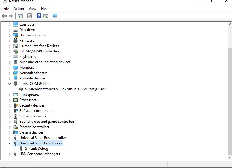

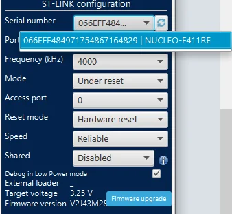

I am a somewhat new STM32 programmer. I recently bought an STM32 Nucleo f411re board, and when I tried to flash code onto it with Platform io, I was not successful. Despite this, I have been successful with a blue pill board. I am certain that my Nucleo board is original. When connecting to my "STM32 CubeProgrammer" I get:
 11:28:24:226 : Error: No STM32 target found! If your product embeds Debug Authentication, please perform a discovery using Debug Authentication
 11:28:24:244 : Disconnected
Strangely, the STM32 cube board automatically notices my device, but can't connect to it.
I have tried uninstalling everything and reinstalling it several times. To give more info, I will show that my computer notices the com-port and I will also display some drivers I have installed:

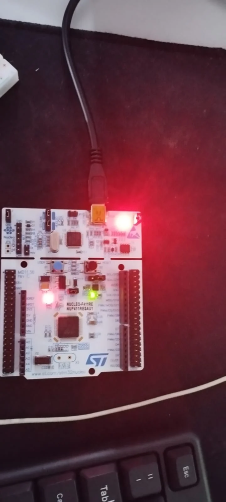

Also, my setup looks like this:
I would appreciate any help and thank you very much.

Hello @TheCorgiMonster ,
Make sure that your STLink firmware is upgraded.
Check the power jumper and the level on NRST.
mƎALLEm
April 12, 2024
Did you modify something on the board?
