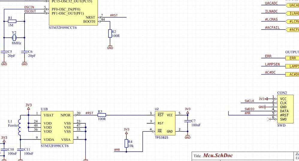

Hello there,
I am working with STM32F098 mcu, it has NPOR pin. Reading the documentation I understood that I have to externally pull this pin low until a stable VCC will be present. When it is present, I have to leave it high impedance as it has internal pull-up.
For this I use TPS3825:
The TPS3825 helds the &sharpRST line low when &sharpMR is low or until VCC reaches more than 3V. My problem is that in my circuit the NPOR pin acts like an output pulling the &sharpRST line low. After I cut off the NPOR line from the &sharpRST net the mcu started to work. When measuring voltage on NPOR pin then it is 0V.
How does this NPOR pin work really? Did I understand something wrong? I would appreciate all help.
#hardware #stm32 #npor

    Are you using the TPS3825-33 ?
    Are you sure it is a TPS3825 ?  and not any of these..  TPS3820 TPS3823 TPS3823A or TPS3828 or TPS3824
    On all these other packages, pin 4 is not /MR  it is WDI
    Watchdog timer input. (TPS3820 TPS3823 TPS3823A or TPS3828 or TPS3824)
    If WDI remains high or low longer than the time- out period, then reset is triggered.
    The timer clears when reset is asserted or when WDI sees a rising edge or a falling edge.
    If unused, the WDI connection must be high impedance to prevent it from causing a reset event.

    TPS3825-33DBV
    I am certain.

    http://www.ti.com/product/TPS3825-Q1
    A push-pull driver for the reset output hardly seems appropriate.
    ♯ POR wants an open-collector, other ARM systems such a pin is bidirectional
