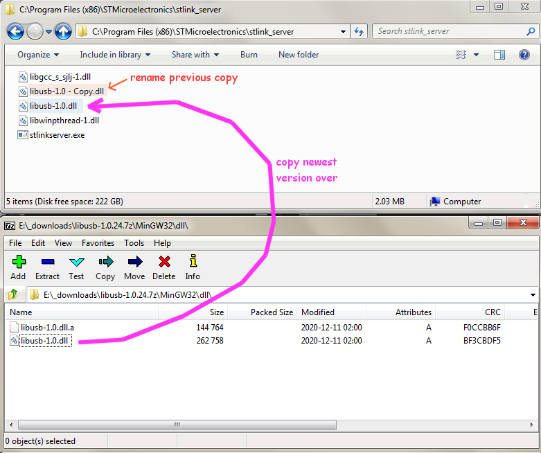

Hey Laurent,
It seems the culprit is libusb. After reading similar posts, I decided to try the latest libusb.
I went out and downloaded the latest libusb 1.0.24 from /libusb-1.0/libusb-1.0.24/libusb-1.0.24.7z and copied the libusb-1.0.dll from the MinGW32\dll folder into the st-link-server folder "C:\Program Files (x86)\STMicroelectronics\stlink_server", kill the stlinkserver.exe process in task manager, and that did the trick!
Now my STM32CubeIDE 1.6.1 can see the debug probes using either the ST-LINK (ST-LINK GDB server) or ST-LINK(OpenOCD) probe options.

Hey Laurent,
Laurent thank you for your pointing me in the right direction to find a solution.

Hello everyone. Finally I have got a solution. Hope this will be helpful for you as well..
I have also encountered the same No st-link detected issue. I have tried installing older versions of cube ide, updating drivers, updating firmware etc. but didn't succeed by anything.
Then I have replaced the libusb-1.0.dll in the stlink server directory. The first time it didn't work. But I kept trying different versions of the libusb-1.0.dll file and finally the issue got solved after installing the latest version of the dll file..
Follow the instructions mentioned by Elope 2 above in this forum.
Here is the link for the latest version of the dll files as of 6th Jan 2022.: https://webwerks.dl.sourceforge.net/project/libusb/libusb-1.0/libusb-1.0.24/libusb-1.0.24.7z
Depending on your computer settings the required file may differ. If you are not sure about how to decide the correct file, just keep trying every dll file one by one.
