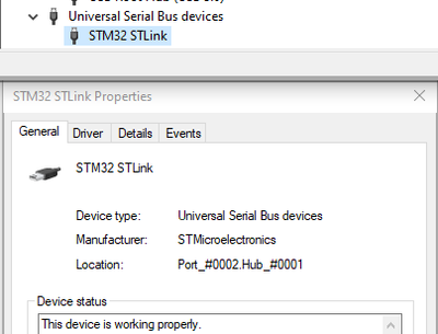

I want to program my STM32F091CC with the ST Link/V2 through Arduino. I downloaded the stw-link009 software and I can push Arduino code to the STM32. The problem is that I can not get serial communication so I can see serial prints or debug my code
I have been trying to fix this issue for several days now but don't see a solution. On other forms I see that it is impossible to get serial communication from an "external ST Link/V2 ..

Correct, you'd need an ST-LINK/V3SET supporting a serial connection or a separate USB to Serial dongle attached to a Serial / UART instance on the board.
Or you'd need a USB CDC/VCP Device firmware running on the STM32, perhaps in the form of boot loader

Normally the VCP is supported by STLINKV2 embedded on ST STM32 boards. is this issue discovered on ST board? or which ST board you are working on? thanks!
sbeuk
I am working with the Barth STG850 PLC. I managed to get serial communication by using the Barth VK-16 cable.
