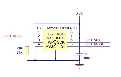

Im using M95512-D EEPROM with STM32F103RCT7. EEPROM is connected with SPI2.
My Initialization and Read Write Process are given below, Please help me to make it work,

schematic for reference:

Chip select managed where?
0693W000001rPUfQAM.pngChip Select is Connected to Ground.
Pierre P.
​Hello
/CS must be with pull-up &  managed by the µc.
If always connected to GND, the device can be selected. That's why you read always 0xFF.

Hi, I'm using only one slave on spi channel . So, is that wrong to keep pull down by default?

Pierre P.
​Hi,
/CS=1 means eeprom deselected.
To select the eeprom, you must pass /CS=1 to /CS=0 before starting communication. The transition high to low is mandatory.
If you always keep /CS=0 , you can't have communication master vs eeprom.
