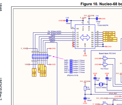

I'm looking for a board that provides all program/debug signal on a header while allowing to disconnect on-board MCU.
I've looked at a few NUCLEO boards - only JTCK, JTMS, NRST, SWO are exposed to a header (with possibility to disconnect on-board MCU using jumpers and solder bridges), but not MCO, STLK_TX and STLK_RX.
Does exist a board that exposes whole this stuff ?
Thanks.
Pavel.
Best answer by STTwo-32
You may refer to this FAQ: How to program an STM32 using the on-board ST-LINK... - STMicroelectronics Community and use the JP5.
Best Regards.

Hello @Pavel_47
I may suggest you the Nucleo-68 board of the P-NUCLEO-WB55, it provide GND, NRST, SWDIO, SWCLK, SWO, TX_STlink (VCP) and TX_STlink (RCP) on the JP5:
For the MCO, I don't know if there is a board with STLINK MCO is provided on a header.
Best Regards.

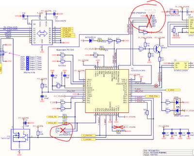

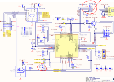

Hello @STTwo-32,
Thanks ! A couple of additional questions nevertheless:
The required signals are exposed on two headers: CN13 and CN14. But surprisingly SWO isn't exposed. Any reason for that ?
Moreover on another document (mb1355-wb55rg-d01_schematic.pdf) there are not at all CN13, CN14. What does it mean ?
Sincerely,
Pavel.
