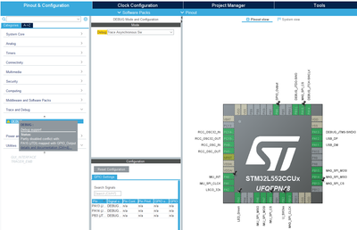

Just to get the details out of the way, I am quite new to STM32CubeIDE. I have a SMT32L552CCUX microcontroller paired up with TDK ICM-42688-V IMU sensor on a custom PCB, this will be my motion sensor device. I am also using STLINK-V3MINIE in-circuit debugger and programmer to deploy the firmware and debug the device.
Debugger settings are all default.
I got PC connected to STLINK-V3MINIE and it's fully updated, its then connected to the pcb (powered on via a different source) via a ribbon cable. If I unplug it and try to debug I get this output:

What is curious though that it does hit a breakpoint in file stm32l5xx_hal_pcd.c at line 1908:
if (ep->doublebuffer != 0U)
If I press continue nothing happens. I am not quite sure what I'm doing wrong. Any help would be highly appreciated.

It should be working with what you are doing.
If connection drops like that, it probably is a hardware thing. Can you share the schematic? Is power rail stable and are decoupling capacitors present?
If you upload a barebones simple code which doesn't modify clock at all, just blinks an LED, does that work?
Andrew Neil
Sounds similar to this:
https://community.st.com/t5/stm32cubeide-mcus/nucleo-l552ze-q-cant-be-programmed-with-stm32cubeide/m-p/704215
@Mahmoud Ben Romdhane
Start with the fact you can't connect.
Does the ST-LINK/V3 have VTarget and GND connected.
Double Check SWDIO/SWCLK connected to the right pins and the orientation of everything is correct.
No connectivity can also mean the MCU isn't viable,most likely not powered, missing VDDA/VSSA
Check NRST level, should normally be HIGH
Provide Schematic of salient sections
Use STM32 Cube Programmer to do this initial connection testing. Check what voltage it reports for VTarget
