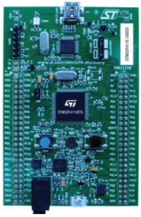

Is it possible to use micro USB ie.,On-board ST-LINK debugger/programmer as virtual comport by re-enumeration ?
  • July 7, 2020
  • 3 replies
  • 2279 views
I have Discovery kit with STM32F411VE MCU (LINK), The product description doeasnt talk anything about the re-enumeration capability of the on board ST-LINK debugger/programmer.
Is it possible to tweak some jumpers or tweak stlinks firmware to use this micro usb as the virtual comport , so that I can use this as USART to USB?

The Micro USB is connected to the F411, not the F103 / ST-LINK/V2 VCP side of things.
Presumably you could put USB Device firmware on the F411 and have it be any device you want?
July 8, 2020
The only way to use the micro-USB as a VCP is to write the firmware that treats that port as a USB VCP device. No jumpers are going to get you there.

the mini usb for stlink includes normally a usart to virtual com port, if you use it for debugging. the benefit is that in this case, you can stop your code under debug without losing the device enumeration which is done by the f103.
