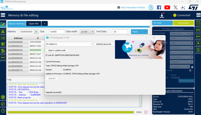

I got my STM32H745I-DISCO (STM32H745XIH6U) kit and wanted to update st-link (STLINK-V3E) firmware. Unfortunately I used unreliable USB cable and it got probably disconnected during the process. Now the STLinkUpgrade shows the line "Unknown firmware type. Don't know how to upgrade."
Is there any chance to restore original firmware? Or do I have to use external ST-Link/buy new board?

Thanks to this page I was able to successfully restore original ST-Link Firmware using the following command:
java -jar STLinkUpgrade.jar -d8_d32_msc_br -force_prog
STLinkUpgrade.jar is part of the ST-Link boards firmware upgrade package.
