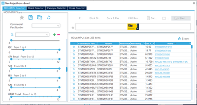

With MCU/MPU Selector (in STM32CubeMX or MCUFinder), you can look for MCUs with I3C and you have also proposals for boards containing it. I made the exercise and this is what I get as result:
I assume that a new version of AN5879 will be available soon to support STM32N6.
-Amel

Thanks @Amel NASRI. That will help to search for I3C-enabled MCUs.
