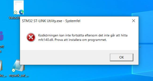

I can download and run STM32 ST-LINK Utility on Windows 10 but my college cant do it on Windows 11 ? Is it possible?

On my Win11 x64 laptop the ST-LINK utility runs just fine.
No any runtime DLL issues.
Haven't tried on ARM yet.
It's not clear what the "can't do it" part describes.
With older software there is often a need to marshal all the correct Microsoft Redistributable packages, usually seen via pop-ups or 0xC0000135 (STATUS_DLL_NOT_FOUND) type errors.
In trouble-shooting issues over at the uBlox forum I found this collection, and this saved fishing specific ones off the Microsoft site, and multiple attempts to find the right one in cascading dependency failure cases.
https://www.techpowerup.com/download/visual-c-redistributable-runtime-package-all-in-one/
Just install a single universal package, which combines all versions since Visual Studio 2015. ST-LINK Utility is 32-bit application, therefore it needs x86 version.
https://docs.microsoft.com/en-us/cpp/windows/latest-supported-vc-redist

Ok, typical error
> Ok, typical error
This is on clean Windows 11?
Install the VC Redistributables, should have the MFC DLLs
LKarv.1
My college run a version V4.5.0 of ST_LINK.. and now it works.
Yes, it was a clean version of Windows
Thanks

Using an older version of the software only because of a complete inability to see the correct answers in the topic...
