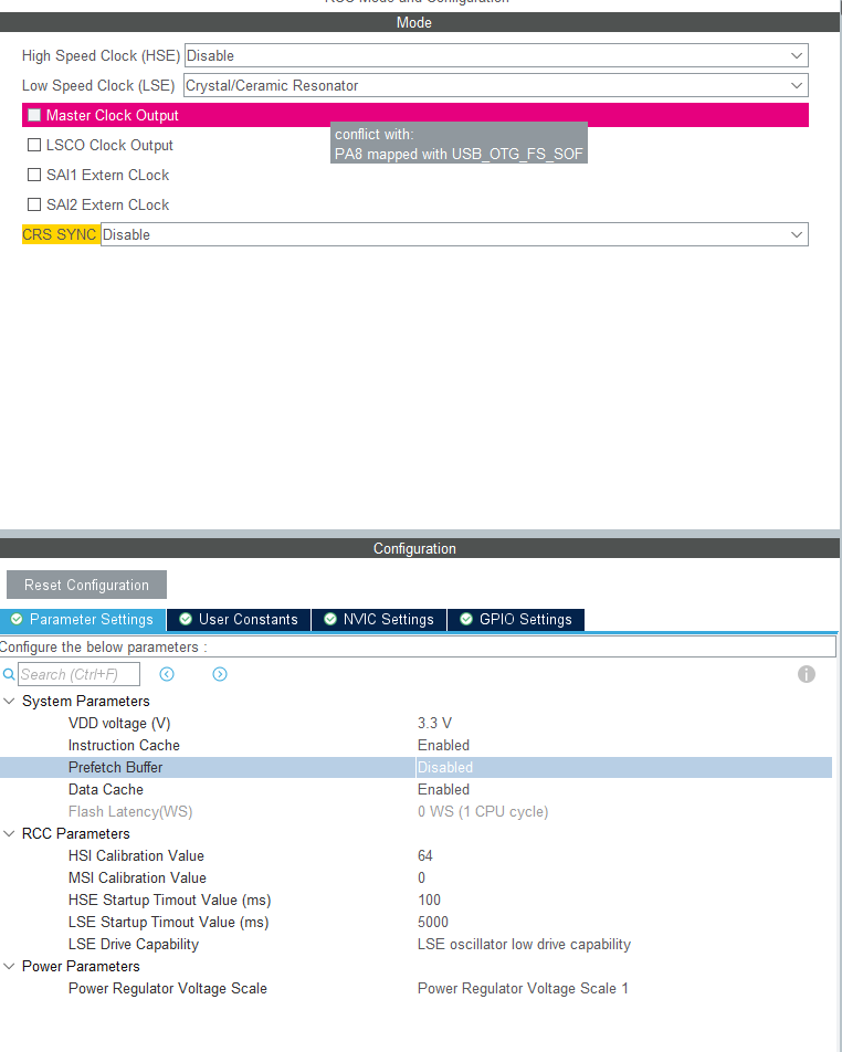

I entered an inifite loop at the HAL_RCC_OscConfig (l 29) of SystemClockConfig() ​

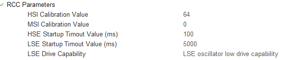

  /** Configure LSE Drive Capability
  HAL_PWR_EnableBkUpAccess();
  __HAL_RCC_LSEDRIVE_CONFIG(RCC_LSEDRIVE_LOW);

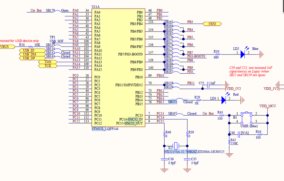

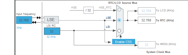

I thought this cause bay be the setting of the RCC configuration mismatch actual board (STM32L496 demo board: NUCLEO-L496ZG) ,but I can't find correct configuration setting on condition of using on board crystal resonator X2.0693W00000YAQIWQA5.png

set LSE drive to high .
