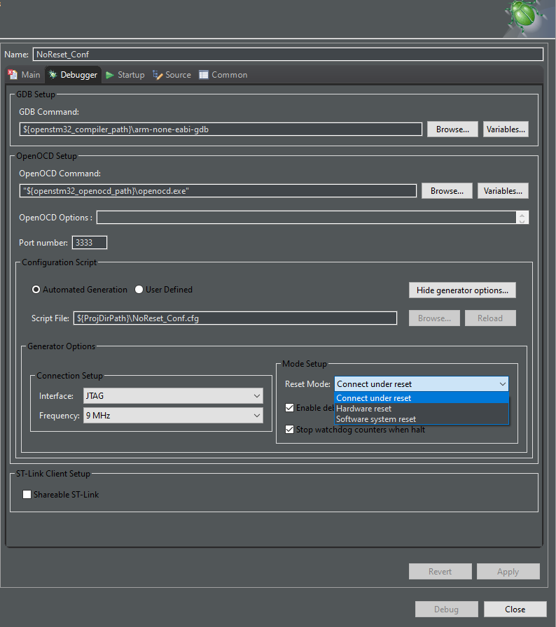

0693W00000HqS3jQAF.pngI've tried to look for the configuration "none" in Ac6, but I've found nothing on it.
The only options I've found are:
  • Connect under Reset
  • Hardware Reset
  • Software system reset
I've tried to google for the same config in the STM32CubeIDE, and I've found this post.
The only configuration missing is "none", where in Eclipse I have Hardware reset.
Might be it? Or is it a completely different configuration?
At least I was on the right track, I tried fiddling with these configs before, but probably never tried that one.
For the moment being, TYVM, really appreciated!
January 3, 2022
Can you connect with STM32CubeProgrammer? It does not reset by default. If you know where the array/data is, you don't need a debugger.
None and Hardware Reset are different. None does not reset while the other pulls NRST low.

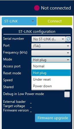

PS any indications on which setting to use with CubeProgrammer?

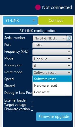

0693W00000HqYnsQAF.jpg0693W00000HqYndQAF.jpgIt should be "HotPlug" for Mode, but any indication if/what to put in Reset mode?
Thanks again!
January 4, 2022
> Problem is, when phisically connecting the STLink cable to the board, something triggers a reset & restart
If the board resets at the point at which you physically connect the debug cable, then none of those settings are relevant here will fix this issue. None of them will change that behavior as those settings control what happens after you hit "Connect" or when you launch the debug configuration.

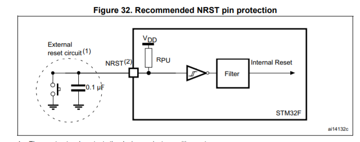

January 25, 2022
Thanks for the tips
I was finally able to get my hands on our custom PCB blueprints, and I noticed that we actually had a capacitor missing.
Thing is: we don't have a switch button for the manual reset (it's not needed), but the line that connects to NRST from STLink is lacking the protection capacitor that (correct me if I'm wrong) protects the MCU from parasitic current/undesired resets.
Would that explain the sudden resets when the STLink is connected?
Now if that is the source of the problem, placing the capacitor would fix the issue. Sadly, it's more complicated than that, so as a workaround:
What would happen if I just do not connect the NRST wire from the STLink, and connect all the others? Would that undermine/risk of damaging the MCU/board, is the NRST necessary for standard communications (even if a reset is not needed) or the NRST signal is only used for reprogramming/restarting/resetting the board?
As a reminder, I do not have any need to freeze or stop the program running, the data i extract are static once the program is completed.
I just need to avoid a reset when connecting to the MCU
