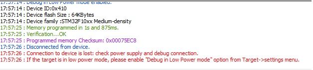

Hi, I am trying to flash stm32f103 board. I am facing connection lost issue. For more details check attached image. Thanks, Aditya

So likely something in your code interfering with the debugger interface pins, or putting the device into low power mode and turning off said pins and logic behind them. Watch for WFI​ instructions.
