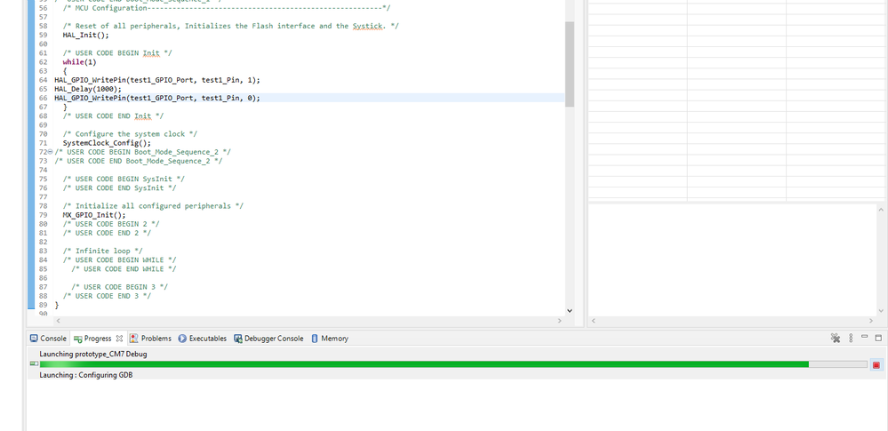

hi i am having issues with the Debug its a M7 and M4 MCU i connected swdio, swclk, swo, NRST, gnd and Vapp

the error:
STMicroelectronics ST-LINK GDB server. Version 5.8.0
Copyright (c) 2020, STMicroelectronics. All rights reserved.
Starting server with the following options:
       Persistent Mode           : Disabled
       Logging Level             : 1
       Listen Port Number        : 61234
       Status Refresh Delay      : 15s
       Verbose Mode              : Disabled
       SWD Debug                 : Enabled
       InitWhile                 : Enabled
Waiting for debugger connection...
Debugger connected
                      STM32CubeProgrammer v2.7.0-RC1
ST-Link Server is running on port : 7184
ST-LINK SN : 30FF6F065647373734141043
ST-LINK FW : V2J37S7
Board      : --
Voltage    : 2.95V
SWD freq   : 4000 KHz
Connect mode: Under Reset
Reset mode : Hardware reset
Device ID  : 0x450
Revision ID : Rev V
Device name : STM32H7xx
Flash size : 2 MBytes
Device type : MCU
Device CPU : Cortex-M7/M4
Memory Programming ...
Opening and parsing file: ST-LINK_GDB_server_a24696.srec
 File         : ST-LINK_GDB_server_a24696.srec
 Address      : 0x08100000
Erasing internal memory sector 8
Error: failed to erase memory
Encountered Error when opening C:\ST\STM32CubeIDE_1.2.0\STM32CubeIDE\plugins\com.st.stm32cube.ide.mcu.externaltools.cubeprogrammer.win32_1.6.0.202101291314\tools\bin\STM32_Programmer_CLI.exe
Error in STM32CubeProgrammer
Debugger connection lost.
Shutting down...

fMoha.1
this is whats happens before i see an error, it is stuck there for 5 min and then error pops up0693W00000Kb2ptQAB.png

fMoha.1
hi
sofLit,
i check every thing, but its not the power or the connection. i solved it by connecting the ST-Link VCC to the board VCC. when i connect the external power then i am having the problem.
