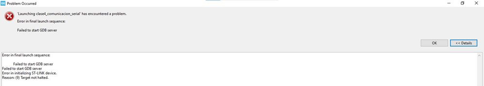

I have a development board with a STM32F401CCU6 MCU. Until now, I had been doing exercises without problems in stm32cubeide. The problem was when I wanted to do an exercise with USART and show the result with the Realterm software, the program compiled correctly and allowed me to debug it without errors with ST-LINK, on ​​the other hand realterm did not show me anything, so I tried to reset the MCU pressing the button, also still had no results, I made sure that the configuration in realterm is ok. Then I tried debugging it again and there it gave me the following error:
STMicroelectronics ST-LINK GDB server. Version 6.0.0
Copyright (c) 2021, STMicroelectronics. All rights reserved.
Starting server with the following options:
    Persistent Mode      : Disabled
    Logging Level       : 1
    Listen Port Number     : 61234
    Status Refresh Delay    : 15s
    Verbose Mode        : Disabled
    SWD Debug         : Enabled
    InitWhile         : Enabled
Target not halted after reset.
Target not halted
Error in initializing ST-LINK device.
Reason: Target not halted.
0693W00000NqjW8QAJ.jpg-I tried compiling it and debugging it with some other exercise that I did before just in case and it gives me the same error

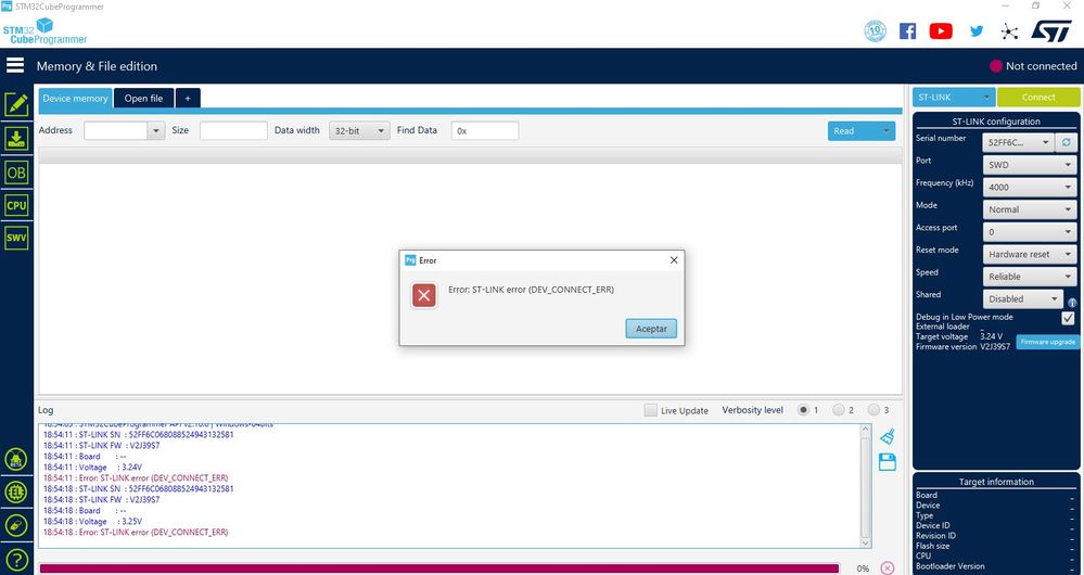

-I also tried to erase the flash memory with STM32CubeProgrammer API v2.10.0 and when connecting I get the following error:
Error: ST-LINK error (DEV_CONNECT_ERR)
0693W00000NqjZ7QAJ.jpg-Another thing I tried is using the ST-Link with a stm32f103c8t6 MCU and it works fine, so the problem comes specifically from the development bord. Any help will help me thank you

Hardware Reset selected, is the NRST pin of the target connected to the debug pod.
If it's not, the device won't be in the state it expects after it attempts a reset.
If you think you misconfigured the STM32 with your USART code, so that it is not responsive to the debugger, you can try resetting the device whilst BOOT0 pin is HIGH (this might be another button), no picture of board or connectivity shown.
If NRST is not connected to the debug pod, it can't reset it. So would recommend connecting SWDIO, SWCLK, NRST, GND and VCC, if this is an authentic ST-LINK/V2

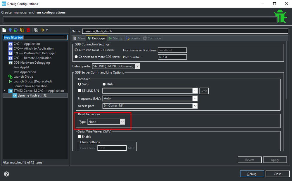

hello, good news... i was able to solve the problem.Pressing Boot0+NRST and then debugging with that configuration.
0693W00000Nqo3VQAR.pngBut I do not understand the cause of the error, if someone explains to me that I do not understand much, Why do we have to select none?
Does Boot0+NRST mean connecting both or grounding?
Check for PA13 or PA14 pins in your code. The STM32F401 uses PA13 (SWDIO) and PA14 (SWCLK) for debugging.
If you modify these pins then the stlink won't work with the board and your mcu will be bricked. To solve this you need to fully erase your chip using stm32cubeprogrammer software. After that your mcu will return to normal state. Please check if this is the issue or not.
