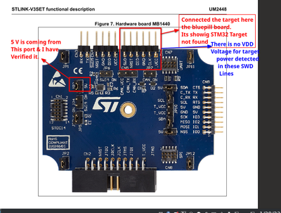

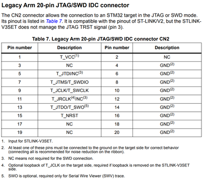

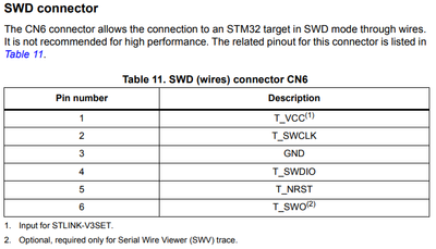

I have a STLINK-V3SET and I'm trying to comunicate with a STM32F103C8T6 (Blue Pill). I'm sucessful only when the board is externally powered by it's USB port. The STLINK-V3SET SWD or JTAG connectors have a T_VCC pin, which I now realized are an input.
The connectors' description in the user manual:
Searching in the forum I've found this post (Solved: ST-Link V3 Set is not detecting the target MCU (ST... - STMicroelectronics Community). We both had the same problem and someone answered him saying that "official STLINKs don't provide supply, but you can customize it".
1) Do STLINK-V3SET really DON'T have a 3,3V power output?
2) If is possible, how can you customize it to supply the 3v3 output?
I'm new to stm32 (less than a week) so I would very much appreaciate any corrections if I said something wrong.
Correct. They do not have a power output. This follows the standard established by ARM, and is common for programmers.
As programs are typically not always run with a debugger attached, this is often not a problem. Power the board how it would be done in the final application.
Perhaps look into a nucleo board rather than a blue pill, as the former will have normal SWD debugging and (bonus) a genuine chip that works and an on-board debugger.
If you have hardware skills, any number of options are open here, but then be aware that your programmer will be nonstandard, which is quite an inconvenience.
‎2024-08-22 7:15 AM

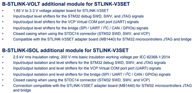

And neither the B-STLINK-VOLT additional module for STLINK-V3SET nor the B-STLINK-ISOL additional module for STLINK-V3SET would be able to supply the circuit with the 3V3, right?
‎2024-08-22 7:36 AM
No. Power doesn't appear on any standard debug headers.
If you are making your own programmer, I'm sure you can find a 3.3V rail on the actual board to tie into. But again, probably better options here (e.g. Nucleo board).
