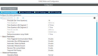

hcan2.Init.Prescaler = 18;
hcan2.Init.TimeSeg1 = CAN_BS1_2TQ;
hcan2.Init.TimeSeg2 = CAN_BS2_1TQ;
Are not a good settings. BS1 and BS2 are very low. So please decrease the prescaler as much as possible and increase BS1 and BS2 as much as possible in order to get the 500kb/s.

I don't think it makes much of a difference in changing the prescaler, BS1 and B2 values as the CAN transmission is working fine.
However, I have also tried testing the CAN receive after changing the values to the following:
hcan2.Init.Prescaler = 4;
hcan2.Init.TimeSeg1 = CAN_BS1_9TQ;
hcan2.Init.TimeSeg2 = CAN_BS2_8TQ;
as well as tried by setting filterIDs to 0x0000.
But even after doing so, it is still not working.
