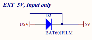

I have a stm32f429 discovery board, can I use its 3V/5V pin as power supply?
Image below is from mb1705c, I'm not sure the meaning of "EXT_5V, Input only".
_legacyfs_online_stmicro_images_0693W00000bisTuQAI.pngI would appreciate it if you could answer my question.

EXT_5V and EXT_3V are internal designations that lead to the network names 5V (P1.1, P1.2) and 3V (P2.1, P2.2) respectively.
Of course, you can also use them as a power supply, but then you should
  • check exactly how much current you can draw from the pins of the DISCOVERY, or
  • make sure that you stay within the voltage limits when feeding in the corresponding voltage while supplying the DISCOVERY.
Does this answer your question?
Regards
/Peter
