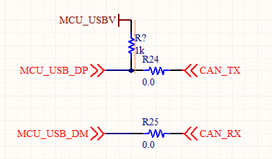

Can I use CAN and USB pin only if USB plugged in?
  • February 20, 2020
  • 1669 views
I am using STM32F103 for my project and it requires CAN most of the time however if a USB connector is plugged in, it should behave like a virtual COM port.
CAN_R and CAN_T pins are connected to PA11 and PA12
together with USB_DP and USB_DM pints.

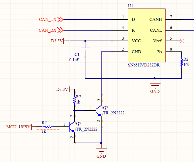

Below image is the circuit I used to disable CAN transceiver when USB 5V exist.
MCU_USBV comes from the USB 5V and USB_DP is pulled up.
This circuit didn't work for me.
What need to be changed?

as CAN and USB share pins, it does not appear that the problem is in trying to use both modules simultaneously.
I believe the main problem is in how the CAN transceiver is "disabled" - floating its GND pin is not a proper way, as the chip gets parasitically supplied from its other pins through the protection diodes.
A multiplexer or a three-stating gate (e.g. 74HC125) or a transmission-gate (e.g. 74HC4016) should be used to isolate the CAN transceiver's D and R from the USB DP/DM terminals.
