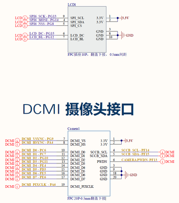

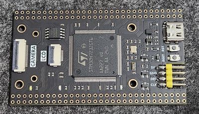

I purchased this STM32H723 mini core board that has 20 pin fpc connector for camera module and 10 pin fpc connector for LCD module.
I contacted the seller on Aliexpress and they told me this board works with OV2640/OV5640 modules, but they eventually told me that they don't have the items available.

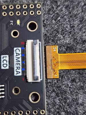

I purchased OV2640, but it turned out to have 24 pin cable.

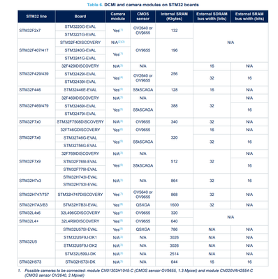

You need to contact the board's manufacturer as the connectors' pinouts are fixed. Meanwhile this is a list of camera modules that can be used in our boards (from AN5020):
According to the schematics, you need an LCD with SPI or I2C interface but again the connectors' pinouts are fixed.
Again you need to check with board's manufacturer.

Yep, I think I'll eventually develop my custom SPI/I2C interface to connect LCD with FFC cable.

Thanks for the links, actually the board in the link you provided has the exact 24p camera interface for the camera model I have. Where the one I have has 20p.
