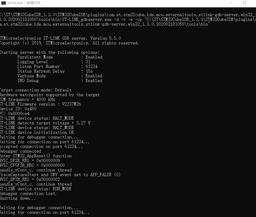

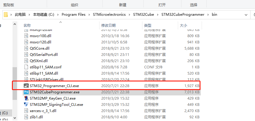

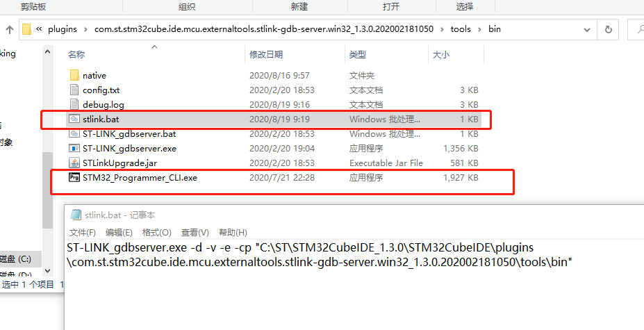

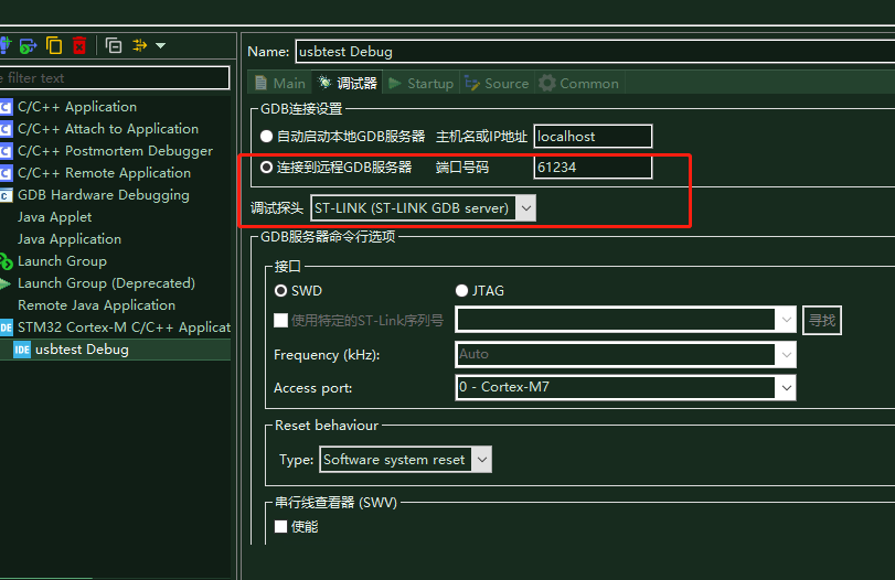

Hchao.1
0693W000003PhrAQAS.png0693W000003Phr5QAC.png0693W000003Phr0QAC.png0693W000003PhqvQAC.png
Not applicable
I think version 1.4 is different, it doesn't have all these files.
Not applicable
Ah got it, you copied the STM32CubeProgrammer files
Not applicable
I was not lucky with that, I used IDE 1.4 files
Not applicable
Note: found the STM32_Programmer_CLI.exe file inside the IDE too
Hchao.1
you can install v1.3.0, then update to 1.4.2
