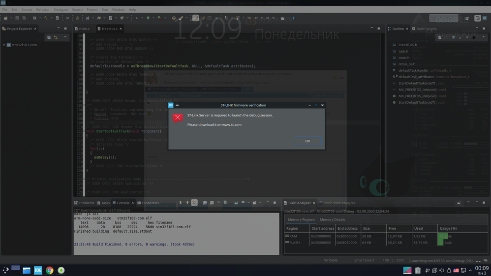

After updating CubeIDE to version 1.4.0 (Linux), the debugger does not work.
AKova.2
0693W000003BtojQAC.pngAfter updating CubeIDE to version 1.4.0 (Linux), the debugger does not work.
A window appears
 "ST-LINK firmware verification"
in which there is a message - "STLink server is required to launch the debug session".
How to fix it?

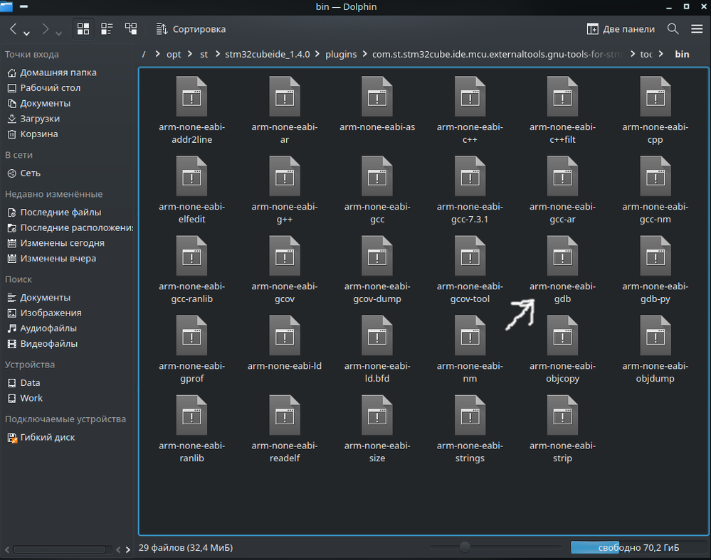

STM32CubeIDE 1.4.0 debugging works for me on 64-bit Ubuntu 18.04. The stlink-gdb-server comes as a STM32CubeIDE plugin. A typical debug session starts both, arm-none-eabi-gdb (which is on the path in /opt/st/stm32cubeide_1.4.0/plugins/com.st.stm32cube.ide.mcu.externaltools.gnu-tools-for-stm32.7-2018-q2-update.linux64_1.4.0.202007081208/tools/bin) and stlink-gdb-server:
$ ps aux | grep -i gdb
frank   28904 0.2 0.0 31968 11968 pts/3   Ss+ 08:40  0:00 arm-none-eabi-gdb --interpreter mi2 --nx -q --interpreter console -ex new-ui mi /dev/pts/2 -ex set pagination off -ex show version
frank   28911 0.7 0.0 34020 4944 ?       Sl  08:40  0:00 /opt/st/stm32cubeide_1.4.0/plugins/com.st.stm32cube.ide.mcu.externaltools.stlink-gdb-server.linux64_1.4.0.202007081208/tools/bin/ST-LINK_gdbserver -p 61234 -l 1 -d -s -cp /opt/st/stm32cubeide_1.4.0/plugins/com.st.stm32cube.ide.mcu.externaltools.cubeprogrammer.linux64_1.4.0.202007081208/tools/bin -m 0 -k
Check if those components are installed in your system. If not, I would try reinstalling.

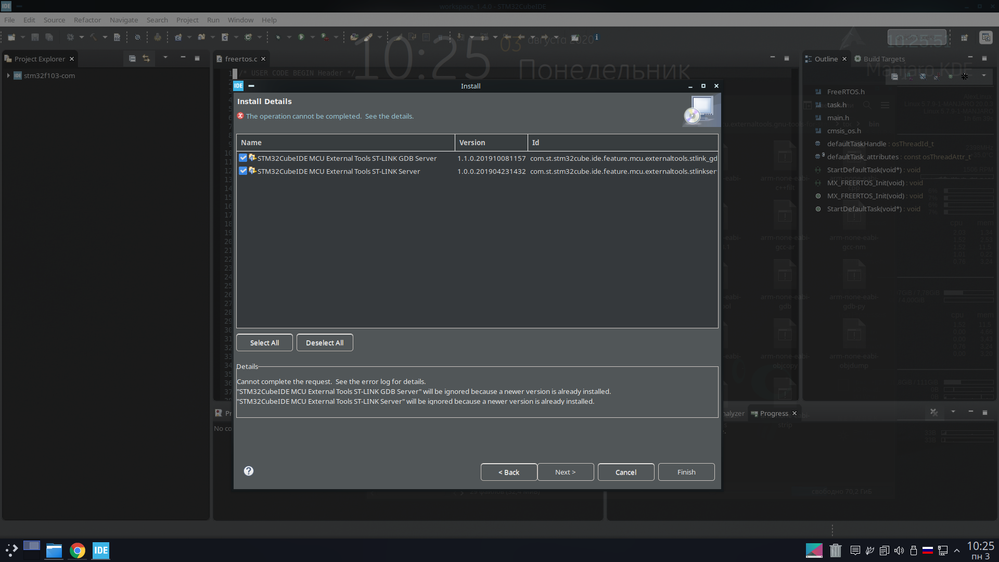

I tried to download STLINK Server from the HELP menu -> Install new software.
Here is the result.
As far as I understand, these elements are present. And the file you specified in the specified path is also there.
I don’t understand what’s the matter ... everything worked before. Ide reinstalled, the result is the same. It works on Windows.

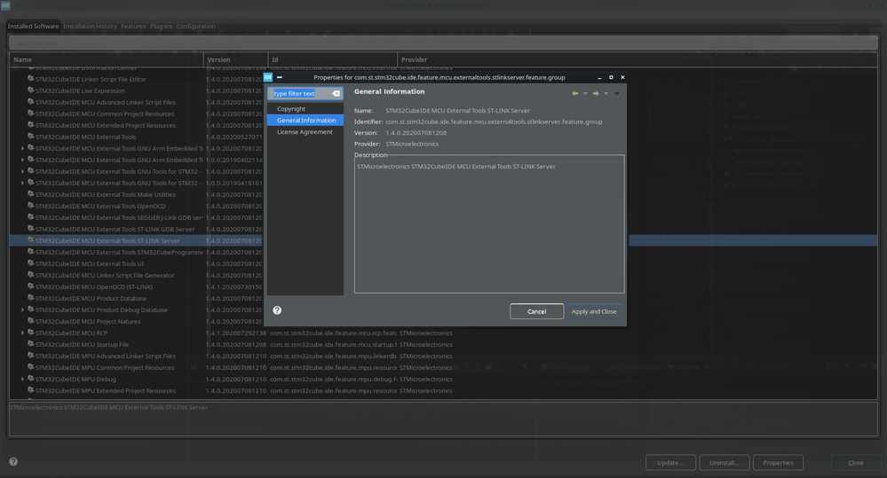

AKova.2

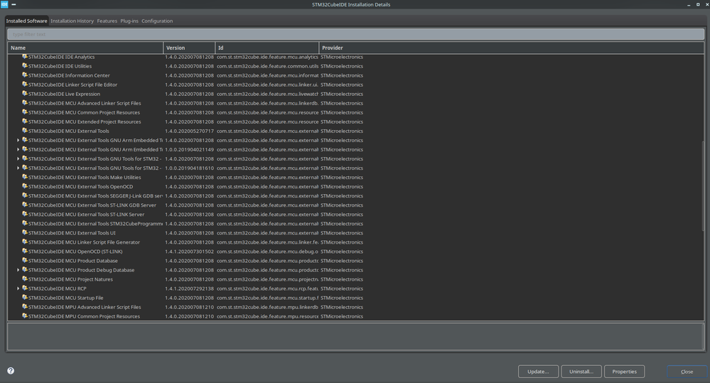

The list of installed packages contains STLINK Server.0693W000003BuxDQAS.png
KnarfB
> Here is the result.
Yes those are outdated versions from last year. The error message is correct.
There should be no need to install STLINK Server separately.
I would try re-installing STM32CubeIDE from scratch.
