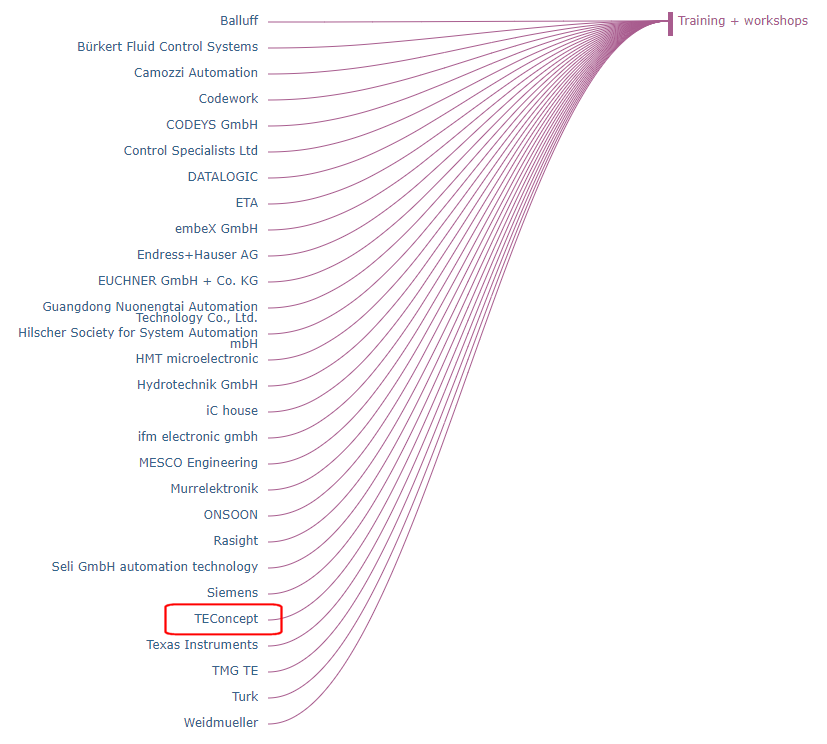

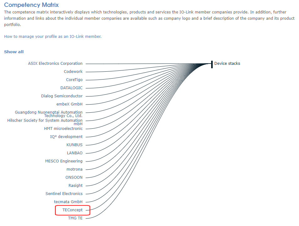

Andrew Neil
Maybe have a look at the IO Link "Competency Matrix":
https://io-link.com/en/WirUeberUns/competencyMatrix_new.php?thisID=43
eg, companies providing Device Stacks:
Training & Workshops:
