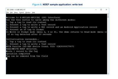

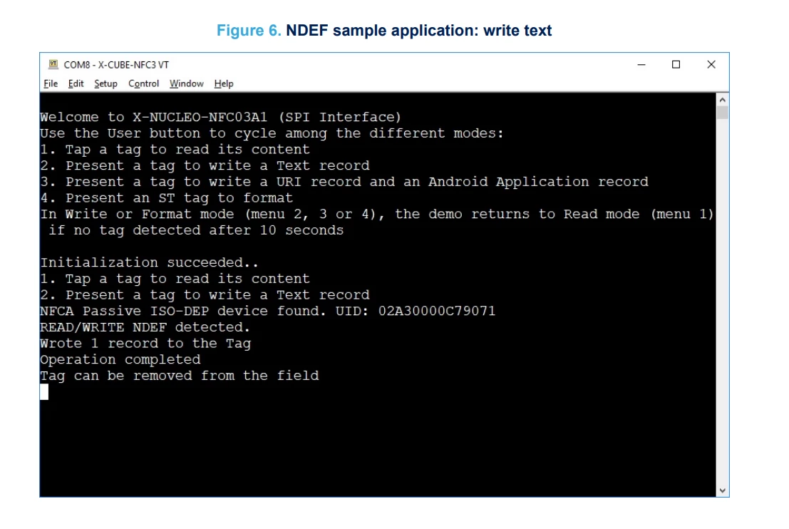

I read Getting started with the X-CUBE-NFC3 near field communication transceiver
and I have some questions about the program that runs in the article, how can I successfully get the interface in the demo, is there a more detailed tutorial?
Brian TIDAL
the binary for this demo is inside the X-CUBE-NFC3 package. You just need an X-NUCLEO-NFC03A1 plugged onto a Nucleo board such as NUCLEO-L476RG. Drop the binary into the virtual drive when the board is connected on a PC through the STLink USB. Open a serial terminal over the STLink Virtual Com Port as explained in the UM2045 and you will see the menu .
