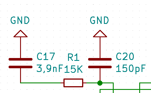

Hi everyone,
I designed my own board for the St25ru3993. Now I am trying to ramp up the RF Field. But before I can do that i need to check if the PLL is locked and the oscilator signal is stable. So i read the AGC and internal status display register. In my case the osc_ok bit and the pll_ok bit are not set, but the rf_ok bit is set. How is that possible? rf_ok bit should be set when field ramp up is done.
What could be the reason for the osc_ok bit not being set? And how to lock the pll?
Thanks in advance

SStad.3
SStad.3Author
August 27, 2021
Hi Bart,
I'm writing my own Code by manipulating the registers via SPI
Now I configured the IC for the TXCO. The status register indicates that the reference frequency is stable.
I tried the Automatic VCO segment selection direct command, but the IC never sends the IRQ. But I also tried other commands like soft_init, this one produces an IRQ. You can see the external parts of the loop filter in the picture at the end. The frequency set, is the standard value of the registers (it should be 867MHz by default), because I just want to ramp up the field for now. I will try to measure the output with a spectrum analyzer next week. Is there maybe a known configuration of the pll section that works ?

Dear SStad.3,
the loop filter values are correct assuming the final assembly is correct as well.

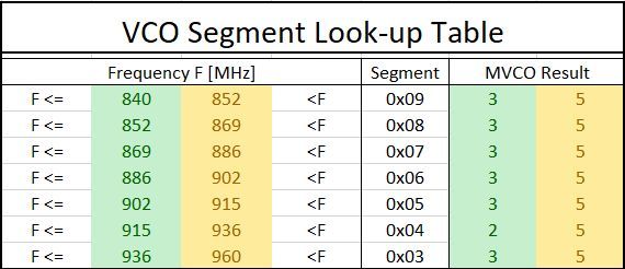

As for the question in you post before asking for known VCO segment settings.
It is possible to set the VCO segment manually as well.
Here is a table that shows for which frequency range which VCO segment should be chosen:
0693W00000DlQBqQAN.jpgThe VCO segment value should be entered into the lower nibble of register 0x11.
Note that the automatic VCO selection should be disabled first by using the direct command 0xA5
The included MVCO Result corresponds to the frequency boundaries.
As it can be seen the target for the segment selection is to keep the MVCO result between 3 and 5 in order to maintain best linearity of the KVCO characteristic.
Information about the MVCO measurement and how it is done refer to the datasheet, section 2.3.1 (VCO control voltage measurement).
Hope this information helps to get the PLL locked.
Cheers,
B
