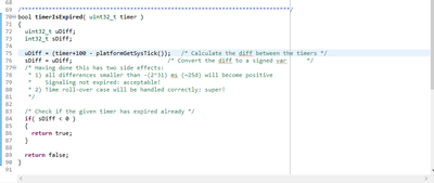

update: The most possible answer of why the integrated board can not work is because the IRQ in hardware actually require a higher signal inpedance, i swap i2c and irq 3pins to other pins and it works
it seems that RFAL goes into error handling as MCU timers expires before the interrupt is being signaled. After C8/C6 commands you often find writing interrupt mask register 16/17/18 which indicates that the function has signaled a timeout - obviously prematurely. Please make sure the platformTimer*() are implemented to wait at least for the requested time.
It should also be useful to enable the ST25R_SELFTEST in st25r3916.c which performs some tests.
BR, Ulysses

I was about seeing similar from the trace - software does not see the IRQ and treats it as timeout. So is your issue now solved by swapping pins?
BR, Ulysses
In the EFR32 integrate board, I swap three pins and then the board could behave like the performanace of the EFR32 testboard(successful rate read around 1/15).
on I2C channel i am kind of sure it should be no problem because both board of EFR32 could go through the test before the loop (VDD Test, OSC Test etc.), so the most suspicious part is the irq pin, by knowing swapping pin could run then i can eliminate the code problem. Therefore, my guess is bad signal impedance of the IRQ part.

Thank you for the detail direction to solve this problem,
I will now check the MCU Watchdog and the platformTimer is setting correct or not , never thought that is the timer function cause the problem.
I closed the ST25R_SELFTEST because the firmware always fail at the RFAL_ERR_TIMEOUT, i think it may also relate to the platformTimer.
update:
I change uDiff = (timer - platformGetSysTick()); to uDiff = (timer+100 - platformGetSysTick());
then the read successfully rate problem tackled, really great appericiate for the help
