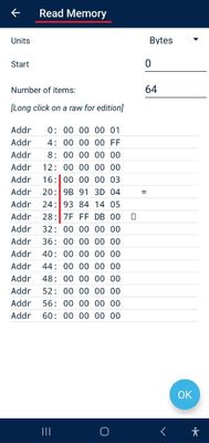

Im using the ST X-NUCLEO-NFC08A1 expansion board and i want to read the HEX Memory of a NFC-V Tag like the ST-Tab App..
Im using the NFC08A1_HelloWorld.ino (github.com/stm32duino/X-NUCLEO-NFC08A1) and it says:
ISO15693/NFC-V card found. UID: E00225031E35C
NDEF NOT DETECTED (ndefPollerNdefDetect returns 5)
Operation completed
The NDEF format is not correct, i know.
Thats why i need to modify the code to make a RAW Memory Data read.
Does somebody know what functions i can use with the RFAL or what needs to be modified to archieve that?

the RFAL provides a rfalNfcvPollerReadSingleBlock() and a rfalNfcvPollerWriteSingleBlock() API.

Thank you for your Help.
It got me in the right direction.
For that Arduino Sketch i used the ndef.ndefPollerReadBytes() function.
That works perfectly for what i need.
