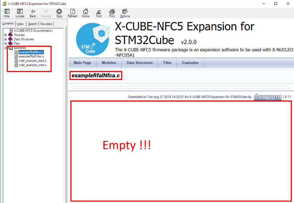

Looking into the rfal.chm file in RFAL there is an example but it does not work for me ?
When I am looking in X-CUBE-NFC5.chm there should 4 examples but its empty.

thanks for having highlighted the issue with X-CUBE-NFC5.chm file. I will report this issue internally. As a workaround, the 4 examples can be found in rfal.chm and ndef.chm files.

which version of X-CUBE-NFC5 do you have? On my side, I have the V2.0.0 and X-CUBE-NFC5.chm provides 2 examples which are not empty (see attached screen shot)
X-CUBE-NFC5 includes ready to build projects for various Nucleo boards (see STM32CubeExpansion_NFC5_V2.0.0\Projects\STM32L476RG-Nucleo\Applications\PollingTagDetect for polling loop on NUCLEO-L476)
