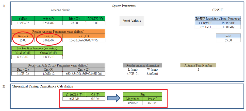

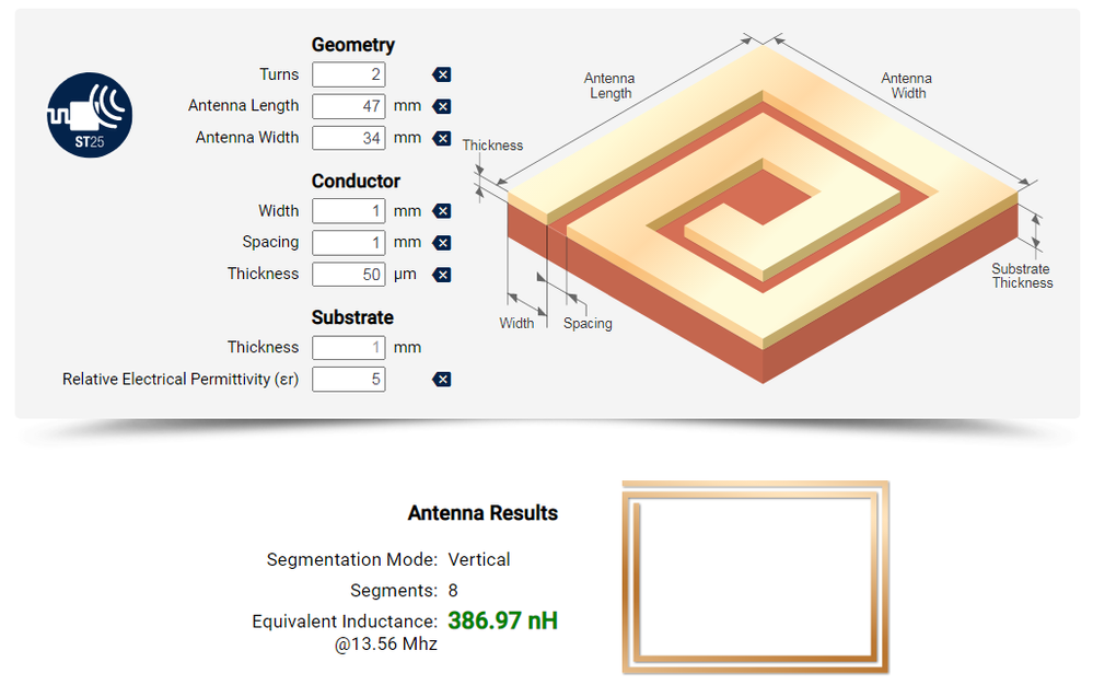

    Hi! Henry:
    Many thanks for your reply to my problem, let me organize my problem in detail.
    1. Until now, my transparent antenna does NOT make yet before that, I want to evaluate the DC trace resistor that the CR95HF can afford or not.
    2. So that, I calculate the antenna equivalent conductor value by designsuite int the first. Please see the Fig-1, that's my target geometry and condition. But the trace material is NOT copper, which I replace it with our transparent material. (The resistor value of square is 0.04ohm/sqr). According to our experience, this total length with our material the total DC trace resistor around 15ohm.
    3. Finally, I fill the above condition to the "CR95HF EMI FILTER CALCULATION rev4_web.xlk" and please see the Fig-2.
    You can find out the "Theoretical Tuning Capacitance Calculation" items are over the system/CR95HF criterion...
    I'd studied the "UM1589User manual" & "AN4327Application note" & "AN3394 Application note" but it still can resolve my problem. Again, many thanks for you to reply my question, and if possible please guide me on how to do this evaluation due to I'm the first time using the CR95HF.
    Have a nice day.
    Fox.

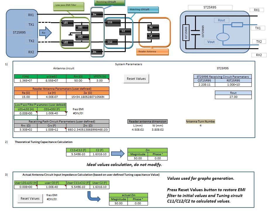

    ​Hello Fox,
    thank you for the clarification. Your original email stated a serial equivalent resistance of 15KOhm which was to big for any solution.
    Removing the EMI filter (L01/L02 & CO1/C02) could help. in the EMI excel calculation tool, fill L01,2 with 0 and C01,2 with 1e-40. the result is C2=163pF and C11,12=560pF (see fig 1)
    bes regards,
    Henry
