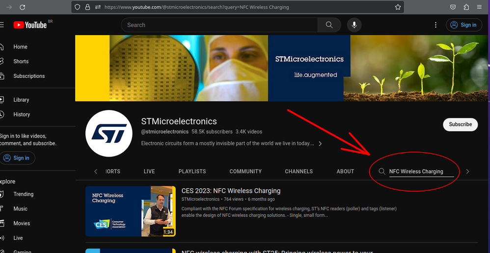

There are some videos about NFC Wireless Charging:
https://www.youtube.com/@stmicroelectronics/search?query=NFC%20wireless%20charging
