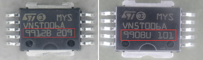

Please help to share any docs showing date code in the top marking for the part number VN5T006ASPTR-E. The marking "209" denotes DC 2209 whist marking 101 denotes DC 2101. Please refer to attached photo for reference. Thank

    The date codes are to be interpreted as always: YWW, which also applies to the VN5T006ASPTR-E, which has the component marking VN5T006A.
    Since VN5T006ASPTR-E was launched in 2012, the examples should be read as:
    • 209 = 2012 or 2022, week 9
    • 101 = 2021, week 1
    Regards
    /Peter

    Thank you so much for the reply. I have a follow up question on this.
    Kindly confirm if the highlighted in the photo marking code 9912B & 9908U are lot codes.

    These codes 9912B and 990BU are no lot codes, but internal codes for production sites.
    Regards
