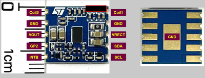

August 8, 2024
we can provide RX MPP module from our vender, you can combination this stamp board to your product.
Visitor II
August 8, 2024
I am interested in the RX MPP module. Could you provide me some more information?
August 8, 2024
add stamp example picture
