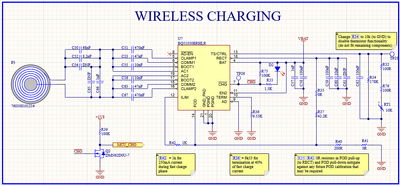

I've designed a PCB with a schematic nearly identical to the STEVAL-WBC86TX. The only modifications are a capacitor and coil size change, which I've also implemented on a development board for direct comparison.
On the development board, my receiver PCB performs almost flawlessly, with the only issue being a charging current of around 60mA (which may be unrelated). However, on my new transmitter board, it almost immediately overheats and shuts down.

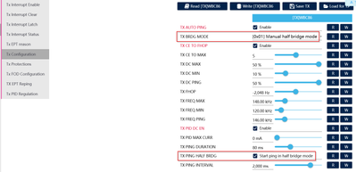

I've attached an image from WPSTUDIO showing the temperature reaching 100°C before shutting down and repeating this cycle.
Can anyone suggest potential causes for this issue or point me in the right direction for troubleshooting?
Thank you, Mike
willzhouBest answer
July 12, 2024
1.For TX/STWBC86 12V input voltage, you must set ping in the half bridge, otherwise the energy will be very high for RX.
2.Also i suggest you modify TX/RX Ctank value. TX use 400nF and RX use about 152nf.

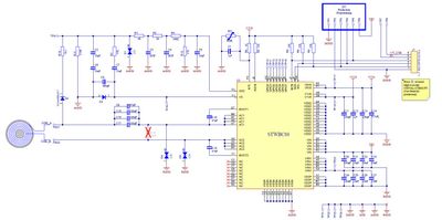

Andrew Neil
July 10, 2024
Show the schematic

Hi Mike
Have you test STWBC86 pins, any shortage? From your GUI logs, vin change from 12V to 5V, what is STWBC86 input voltage?
Our reference is 5V input, please limited input voltage and current.
What is your application power, 5W or above?
@Didier HERROUIN please help to add comments, thanks.
