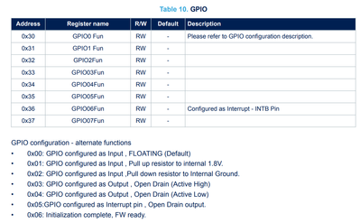

I'd like to use GPIO00 ... GPIO04 as outputs to select the used coil from a coil array for power transmitting.
I've seen the i2c addresses of the GPIO's configuration at 0x30 and followed. I'm wondering what address is foreseen to read or write the GPIO data. Have I overseen anythink?

See Table 10 in the datasheet for how to configure these pins. Note that they are open drain.
https://www.st.com/resource/en/datasheet/stwbc86.pdf

To configure the pin as open drain low (i.e. outputting a low signal), set it to 0x04. To configure it as open drain high (i.e. high impedance), set it to 0x03. Is this not what you're seeing?
As an open drain output pin, these are the only two states it can be in. No other GPIO data register is necessary.

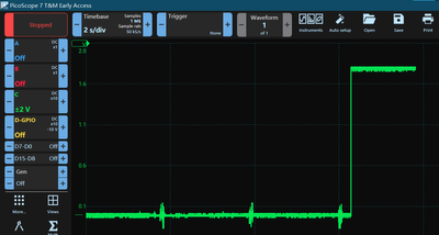

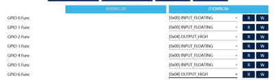

willzhou
Hi Andreas
I understand you want to control gpio high or low,
for example control INTB/GPIO6 high/low set as below
or use I2C reg command W 0x0036 0x04 set high
or use I2C reg command W 0x0036 0x03 set low.
Also you can use other GPIO, Test waveform
