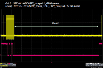

I was recently testing the FOD reping behavior and noticed that when FOD is detected and FOD reping is enabled, the TX retry delay is fairly short (a few seconds).
Are there any settings to increase this time delay?
If a foreign object keeps getting detected, does the TX eventually increase the reping delay time?
It seems that with this short of a delay the foreign object could still heat up as the charger still transfers power every few seconds.
Best answer by willzhou
Hi
please use this version, it have max 65sec and do reping
https://github.com/STwirelesscharger/STSW-WPSTUDIO/blob/main/a23_wbc86_FOD_Delay0xFFFFms_downfw_p1262c1244.bat
yellows is STWBC86 AC signal

Hi

Great, thank you! Is this parameter modifiable through the GUI? Or is there a way to merge it with my existing config file?
December 20, 2024
Hi sir
current this parameter can not change from gui, we can make some common value for your choose.
pEEterAuthor
December 20, 2024
Ok, thank you. Can I provide my existing config file and the desired value?
December 23, 2024
please download config here, this is max 0xffff/ 65535 ms delay for fod
