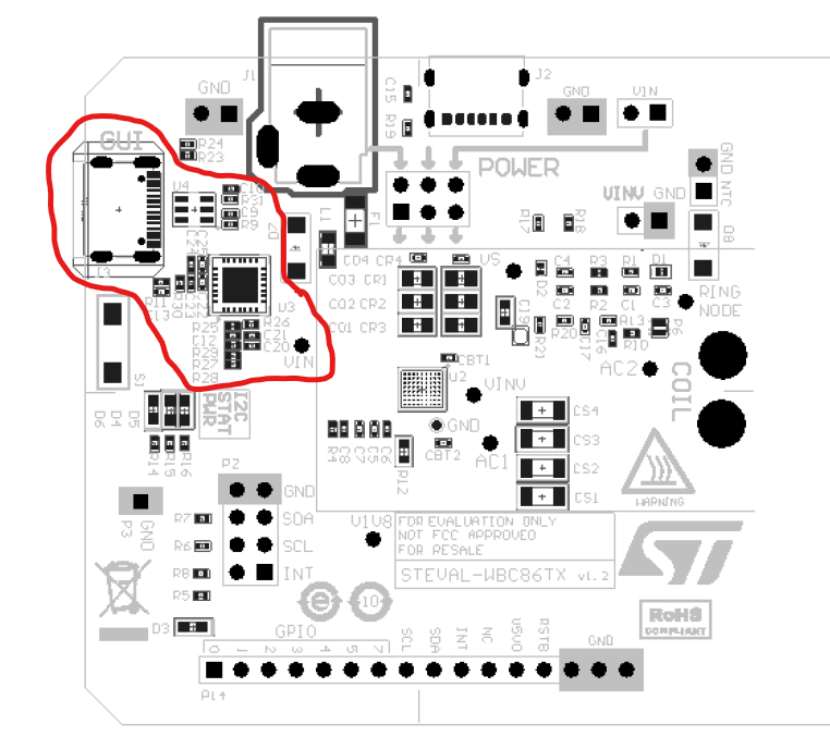

I am currently working on the implementation of the STWBC86 chip, following the STEVAL-WBC86TX as a guide. If we want to develop a PCB with the STWBC86 chip, is it possible to load the initial configuration by connecting the PCB via I2C with a USB converter to the computer? Or is external hardware, such as the STM32 development board, required to load the configuration onto our PCB?
Thank you in advance for your attention.

Yes, it turns out that what we want is to replicate the STEVAL-WBC86TX and just remove some things from it, but we see that it comes with a configuration using the FT260Q chip that would be the U3 (in the image), which they use for I2C Communication, converting it to USB- C and from there to the PC. I would like to know if with this same STEVAL chip we can upload the initial configuration of the new board.I2C.png
October 11, 2024
yes
it is same with STEVAL-USBI2CFT Dongle chip
