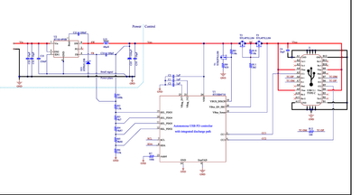

I am using the STUSB4710AQ1TR to charge some USB-C devices at the default 45W. I am operating in a mode that's only charging (no data communication). To do this, I used the recommended application schematic provided in the datasheet. My input voltage (Vin) is a 24V source created by a TI LM5116 (because my input voltage for our system is 48V and the ST1S14PHR cannot handle that high).

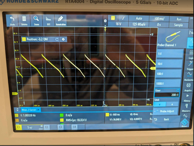

When I am under load, the circuit works as intended and achieves the 45W power charging. However, when there is no load, I hear this clicking noise and the output of the LM5116 is much more variable. I've included an oscilloscope shot of the input voltage at no load.
I am using the same LM5116 circuitry to power some USB-A circuitry at 5V, and it does not experience this oscillation.

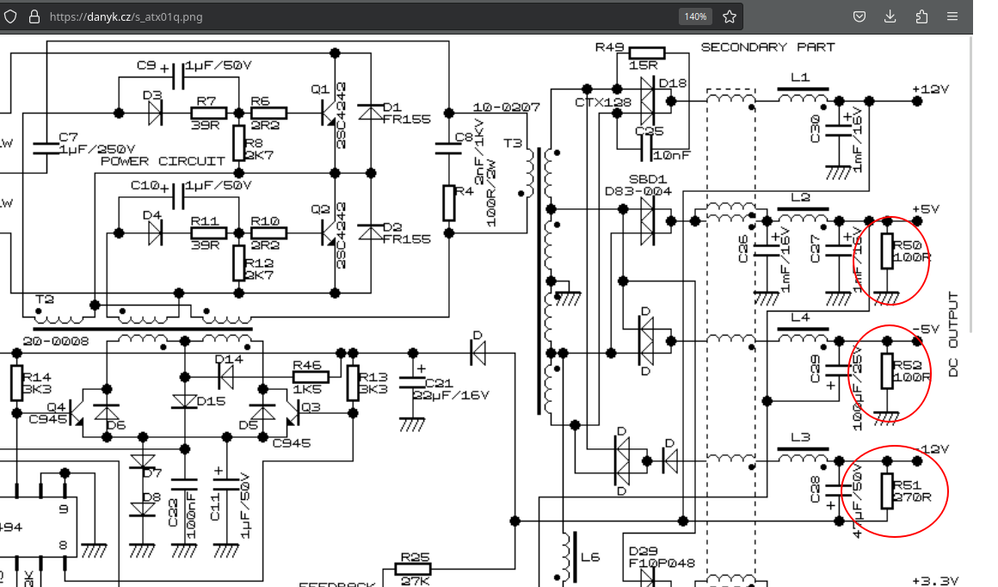

Computer ATX power supplies usually have a load resistor.

Interesting.
So they constantly have something to draw a little bit of current just to satisfy the needs of the converter? I was not aware of that! (Still green to the field haha).
