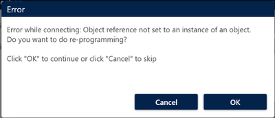

I get an error message when I try to connect with the STEVAL-WLC38RX evaluation board using STSW-WPSTUDIO.  I am using v2.7.2 of WP Studio.  See error message attached.

I'm including the error message here for convenience. It seems like it is connecting but throwing an error.
It show you have some error with firmware in rx chips, if you click OK it will go to re-program.

also suggest you try other version of GUI
GitHub - STwirelesscharger/STSW-WPSTUDIO: ST wireless charge chip tool
OR you can use console way to download fw.
https://github.com/STwirelesscharger/STSW-WPSTUDIO/blob/main/a1_wlc38_downfw.bat
This github no longer has the firmwares.  Is this in a new location?
