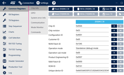

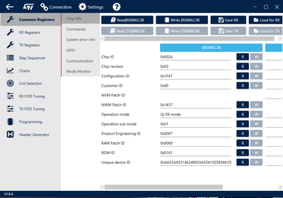

4.What is RX fw version, please give below picture to me.

4. My Rx fw version is:

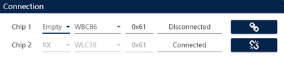

You can use "Empty" to connect again.
Unfortunately "Empty" does not work.
It is not wrong config id or patch. It is like the WBC86 is not there at all.
