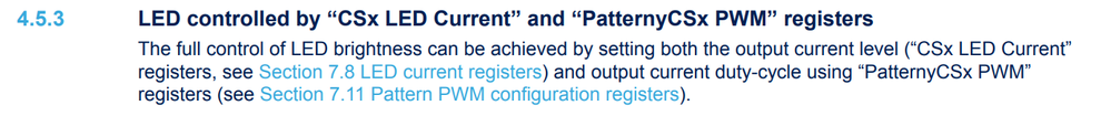

Hello ST Team,
We are observing that LEDs are minor glowing, during turn off condition due to leakage current. As per our application we are not not using any PWM configuration for LEDs. We are just making LEDs turn ON/OFF as per application requirements.
Is there any register configuration available to make LEDs completely turn off?
Or we can use below registers setting to make complete off?

from ds :
So you have to use/set the LED current + PWM , to switch a LED fully off.
