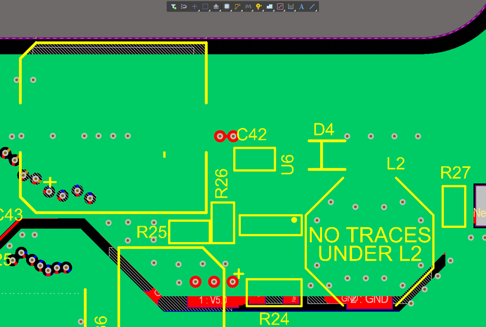

I am using the MC34063ECD-TR to take 5V and make -12V. I'm using the schematic as recommended in the datasheet for this application (with the exception of using a 100uH inductor instead of a 90uH inductor). It is working nicely electrically - I get a pretty clean -12 Volt rail from it. The problem is I also get a loud audible hiss from the inductor. I can press on the inductor with my finger and it dampens the hissing sound. It's around 4 to 8 kHz based on my phone's FFT app, but to my ear it sounds like white noise.
Another problem is I get a lot of radiated emissions that is really messing up my analog gain stage. I have amplifiers taking a 30 kHz signal and amplifying by 110 dB (I'm taking 25uV and amplifying it to about 7.2 V). The amplification works VERY nicely under 1 of 2 conditions:
1) I depopulate the MC34063 (telling me it's either conducted or radiated emissions from the MC34063 interfering with the gain)
or
2) I cover the gain stages with a grounded metal box. (confirming it's actually 100% radiated emissions, not conducted). It's actually pretty neat - I can look at the output of the gain stages and as I cover it I can see the noise get smaller and disappear entirely.
I'm thinking this problem could be coming from a "bad layout". My question is: What pins of which parts need to be located physically close together to minimize the switching current loop for the MC34063's inverting DC-DC Converter using the datasheets recommended application schematic.

Pins 4, 5 and 2 path - short as possible.
I cant see the inner grounds to well on the views, but do see the "seperation" of the top/red layer grounds between the Inductor and C43 ground. as an experiment, try a slice of copper tape soldered in a fashion over the top of the ic, to connect the grounds together. it seems you have enough vias in some places , but i have seen a lack of just one via for an TI parts IC ground to cause it to get squirrely. worked fine on prev rev, then the via got dropped of the pcb on the next rev....sooo back to the pcb shop LOL!
another experiment maybe take a short piece of wire, solder to connect the top grounds together in the spot where the silkscreen marking is for L2 and r27 ~ area

First let me say thank you for your suggestions! I appreciate all help I can get.
My second layer (this is a 6 layer board) is a solid ground underneath of this circuit. The slice in this screen shot is because I physically separate the amplifier and ADC circuit that is next to this regulator. Connecting a ground on top of the circuitry shouldn't help (except for covering the inductor with a shield).

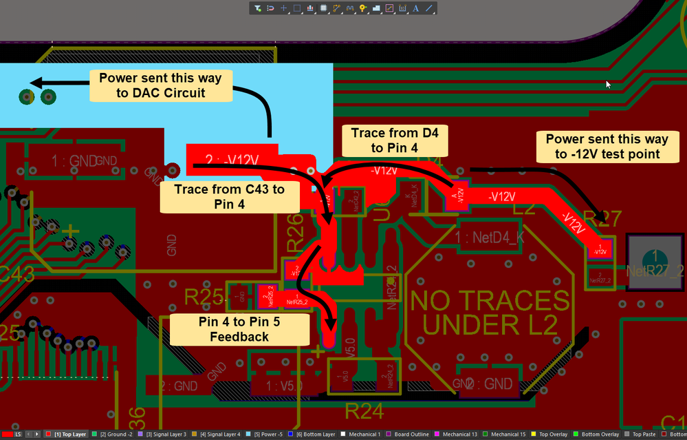

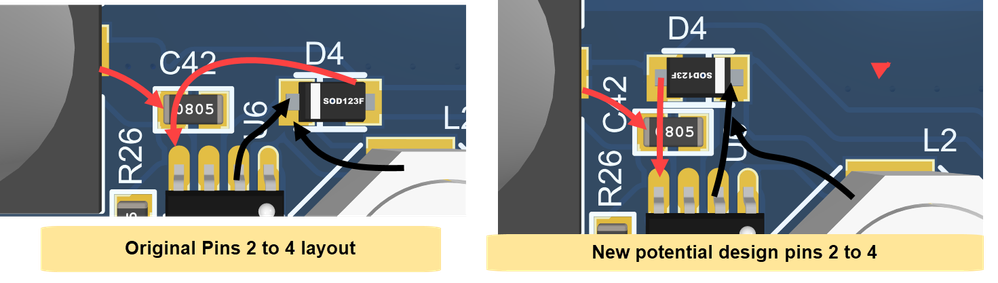

And I believe my pins 2/4/5 have very short traces, but maybe D4 could be closer to pin 4??? What do you think?
Here is how it is laid out:
MHolt.16
MHolt.16Author
September 13, 2019
Perhaps I could flip the diode over and get it closer to pin 4. What do you think about this? Could it solve the problem?
