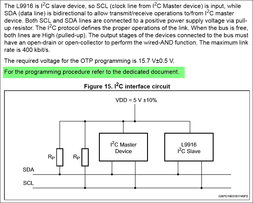

We are to evaluating the L9916 (Multifunction alternator voltage regulator...). From the datasheet I learned that there are OTP registers which are programmed by I2C – as described in section “OTP Programming�? on page 30. Okay, but in addition we need a list of the registers and possible values, information which is not included in the datasheet. Please help.

For programming the OTP registers please refer to attached application note.
