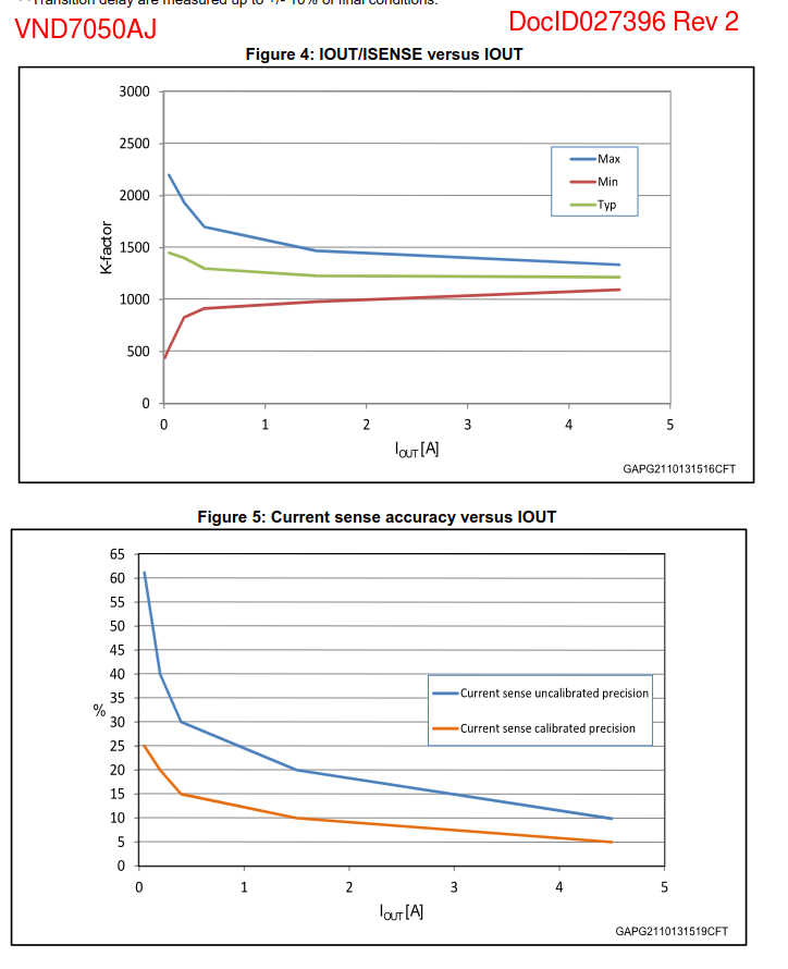

   How to calculate k factor in VND7050AJ High side driver for current measurement?

Isn't Figure 4 already the value of K vs Electric current from the output?
(And an accuracy of 5% to 60% does not seem very interesting to me, Fig. 5. See the ACS712, it has a non-linearity of 1.5%)
