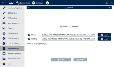

Hi Im trying to program an off the shelf STWBC86. it was my understanding that i only had to download the config file the it would work. can anyone help me please?

    For update of FW (patch and config) in STWBC86, the easist way is to use
    our dedicated GUI available on https://www.st.com/en/embedded-software/stsw-wpstudio.html and the FW itself is available on https://www.st.com/en/evaluation-tools/steval-wbc86tx.html#tools-software. The step-by-step procedure on how to update the FW is described in User Manual UM3161.
    Please let us know if you have further questions.

    Hi Janice, I'm also trying to program a STWBC86 but the links for the FW and the User Manual are broken links.  Can you let me know where to find these files?
    Aug 19, 2024 7:18 AM UTC
    Sorry this file is update now
    ABOUT FW please go to GitHub - STwirelesscharger/STSW-WPSTUDIO: ST wireless charge chip tool
